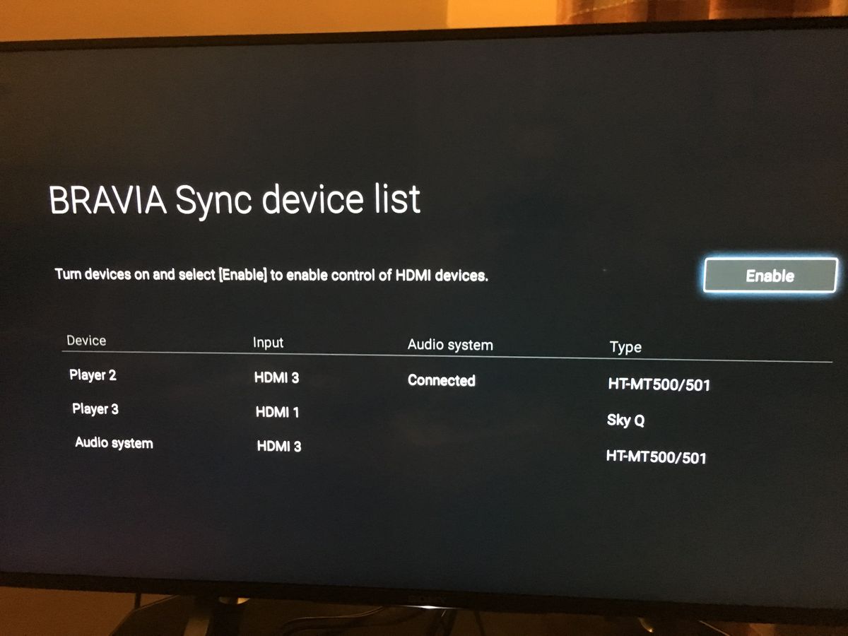

My apologies its Playback_2.........no idea where the TV is getting that from....the TV has also had a factory reset

In sync menu you should not see the sound bar at all...you should see it in the home theatre control menu (in audio) and in the bravia sync menu in external settings

This is where i left it last night....The TV has also had a full factory resetIMG_2280.jpg

Ok this could be ok since my soundbar has not any playback capability while your I think could play music files via USB.
It's strange that even if you reset the TV and SkyQ is not connected you still see it on the list. What's happen if you push enable? it should send the HDMICEC enabling command to the soudbar and you should see something line "Complete" on the soundbar display.
Do you see afterwards the soundbar setting in the setup->sound-> Home theatre control? You should be able to command completely your MT500 via the TV...

Yes i see an enable button and when i press it it gives a message to say its sent a message to the device but then nothing happens. I can control the soundbar with the TV remote.
Funny though that the Home Theatre screen doesnt always allow me to change the settings....sometimes it just shows me a compatibility window.....almost as if its NOT compatible.

As I said it should be related to the fact that your HT (unlike my old HTCT350) is able also to play music. But this should not be a problem.

You should be able to do it, disconnecting everything (when not powered on), redo the display braviasync device list and enable... you shoudl see nothing. than reconnect the soundbar (always powered off both tv and bar) and redo it.
