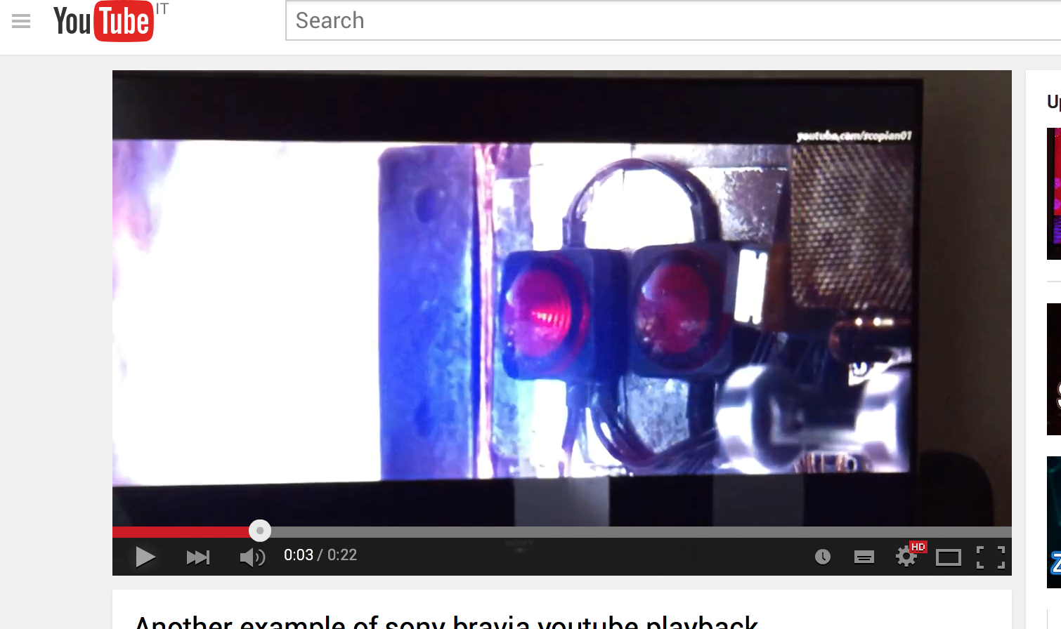

Don;t get me wrong but I've tried to play the first video (https://youtu.be/uy9mnBw5S3M) from my Mac and it is a mess indeed. White rectangles appearing, pixelation, noise. Here an example:
Is it what you're getting?
adam_b82
Hi yes that's exactly what I'm getting :slight_smile:
Seems strange that it's only youtube, netflix and amazon are perfect....
Jecht_Sin
Passionné
Ok, but that's that particular video. The screenshot is from my computer, not the television. It seems to me that the video has been badly converted inside YouTube. Then if you watch in on television it looks even worse due to the much larger screen.
What you should do is to search for "4k HDR" videos and watch those ones at full resolution (2160p). If they show fine (as I suspect they will) the television is ok.
adam_b82
Ah sorry I see the confusion!
Try the first video from the BBC Graham Norton show. It is literally happening to a lesser / worse degree on any video
