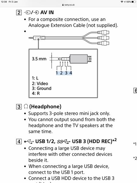

Total newbie question - but I plug in a aux cable into the audio in and connect the other end to my iPod. I then change the source to the AV so that I can listen to my music on the Tv. However the TV says there is no signal...

I take it this is going into AV In (2) and not headphone out (3) which is not an input?
Your connecting cable needs to be a four-pole, wired thus:-
But I would guess you are plugging in a three-pole audio cable? So you need to get from three-pole to four-pole, probably with a three pole female to two male phonos cable, and then a three female phonos to four pole, like the one in the picture above, and then use just the L and the R female phonos.
Though it may anyway well be that the TV detects no input video, and so gives no signal, not even from the sound channels.

@royabrown2 and @kinggo01 - thank you both - I have a three pole - so will just buy a four pole!

Okay - so I bought a 4 pole - plugged it ito AV In (2) and other end to iPod - turned source to AV + play music - still same issue - says "No signal."
Ahrgh - any help would be appreciated!

AFAIK, not all 4 pole cables are the same.
