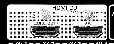

What I *think* is happening is that you are using Netflix and the audio is DD+ and the optical connection to your AV Receiver is not downmixing the DD+ to something it can support.  I dont think DD+ can transmit over optical/SPDIF due to bandwidth requirements and hence the audio is cutting back to the TV.
What I dont get is why you are using an optical cable connected to a *lovely* AV receiver.  Simply use a HDMI cable instead and connected to both the ARC ports on the TV and AV Receiver - Your AV Receiver certainly supports it:

Cheers for the replies, I managed to get HDMI ARC working and this has resolved the issue.
