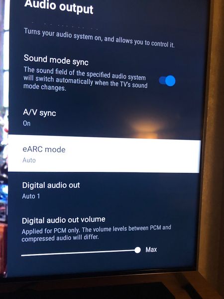

I've got eArc set to Auto on the TV:

Still no luck though.  Although the audio does play through the soundbar, and the soundbar displays 'TV + eArc' when connected, it seems like there is something missing between the two devices.  The soundbar remote works fine, which means I can at least change the volume.  The soundbar doesn't switch on or off with the TV, so there's something amiss somewhere.
