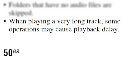

Just a quick update...
I've had another look at the manual and on Page 50 it mentions the following:
This might be what I read previously. Hmmm, I will test this theory on my USB stick.
I also noticed just now on page 48 of the manual that it also mentions that an error will be displayed if you connect an unsupported iPod/iPhone device. I'm guessing that as I have received no such message that my device is recognised and supported regardless. Perhaps there are geographical differences with the STRD N1040. I live in the UK and our models do not have Blu-tooth much to many peoples disappointment.
