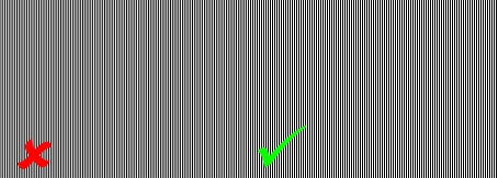

Firstly, we need to check for the correct picture size. In general, TVs will enlarge the provided signal slightly which results in a picture that’s not as sharp as it could be - you might be able to notice this by looking at the resolution stripes which show a kind of moiré effect. To see the true picture size, go to ‘Settings’ > ‘Display’ > ‘Screen’, then set auto display area to ‘Off’ and display area to “Full Pixel”. Now you should see the full arrows in each corner and the moiré in the resolution field should have disappeared.

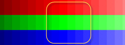

Adjusting Colour Saturation
Adjust the colour saturation to a level that allows you to notice a difference between all the color gradations on the test chart. Be sure to pay particular attention to the centre part of the colour scale and the image in the middle of the test chart to ensure that skin tones look natural.
