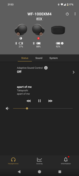

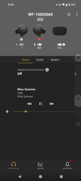

Like the title states, my left earbud randomly started draining extremely fast.
I suspect the 2.0.1 firmware.
I bought these in Denmark on February 17 last year and now they are essentially worthless as I can only use the left earbud for about 40 minutes.
I have since moved countries to Japan, so I don't know what to do about warranty now 😞
I have a attached pictures showing the battery drain using both over about 1 hour.
Sony please respond.
