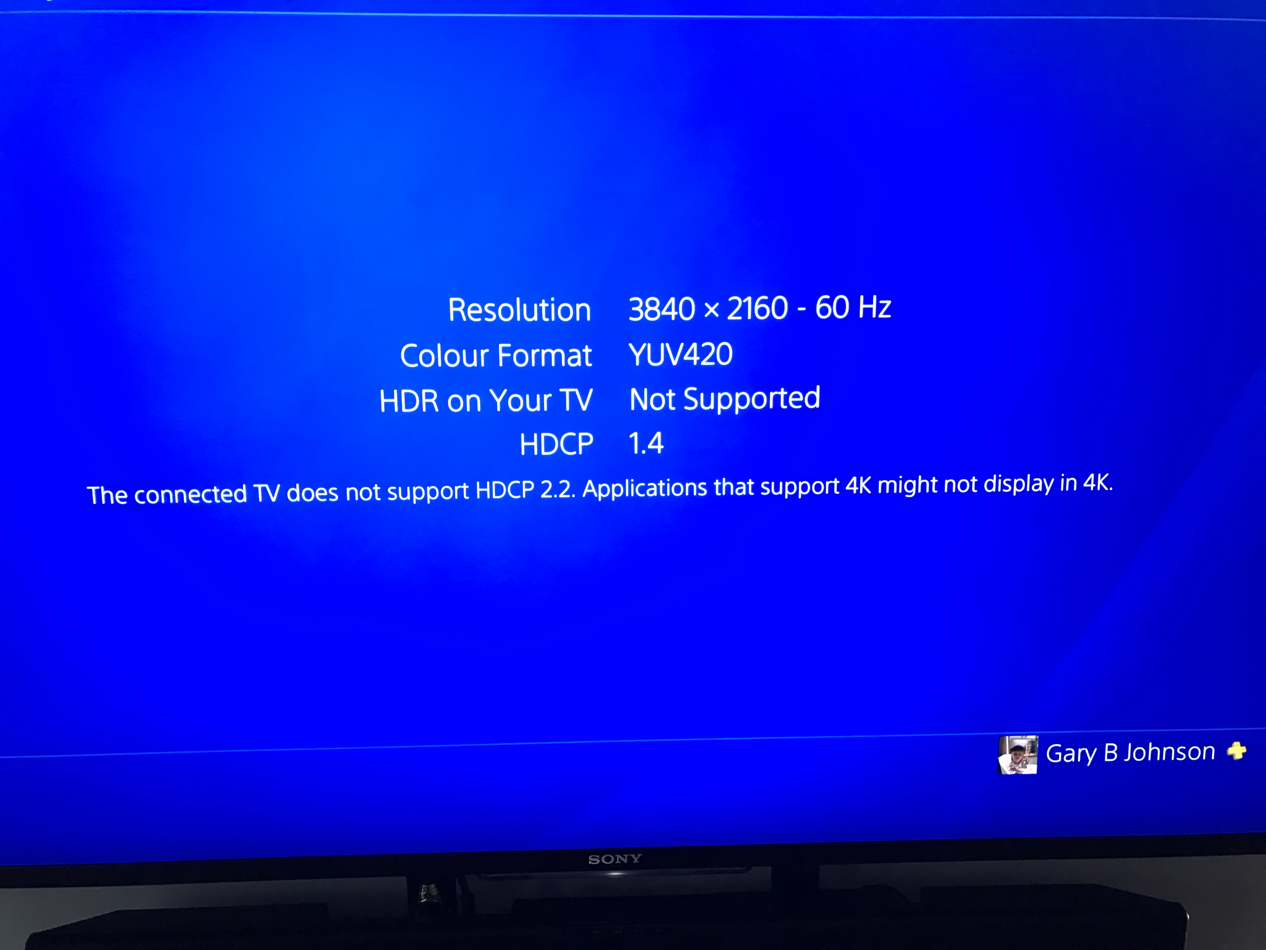

Hi
seen this on my PS4 pro when it said my device didn't support UDCP 2.2
apparently of the 4 HDMI ports only two support UDCP 2.2 , also I am at work so cannot change my hdmi slots to check this out will try later.
note I nearly installed sky Q but doing this research seen that about the ports and SKQ needs UDCP 2.2 support to work so need to find out which ones support it.
see image below mine is runnning 4K but the UDCP needs sorting in the Tv to work
out what's what and if I can have sky Q
Hi Jed,
This is the message I'm, and I assume DrCalypso, getting, I'm connected to HDMI1 on my TV, so check your one out!
That does look like a setting change only m
mine is saying HDR not supported but it's a Sony 4K HDR Tv?
KD-55X8505B
That's exactly what it displays for me @clarke316.
I'll definitely check the "enhanced HDMI" setting as soon as i'm home, but it might take a couple of hours.
So in case anybody will be able to check it before, please share your experience.
Also, just because there might be a difference in Ports (even though sony says there's not), my pro is currently connected to HDMI one directly.
