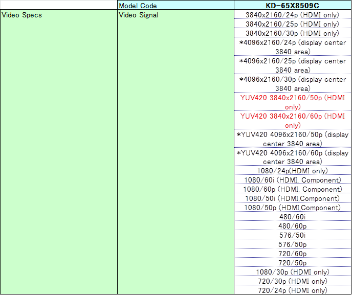

Hi Guys
There have bee a few questions about:
  • HDMI Cable Specs
  • 2160p / 50hz etc
HDMI Cables:
  • You needs to use specific HDMI Cables that supports 18Gbps = Premium Certified
  • You must enable 'Enhanced Format' in the settings, see FAQ = HERE
TV Specs - 2160p at 50hz
Sony confirms 2015 4K models support 4K at 50hz via HDMI - otherwise NO content would be viewable in 4K from SkyQ Silver boxes.  As an example, for the person who has KD-65X8509C see table below (highlighted in RED)
#Note: Sony will look into why this information is not published on its support website under specification.
