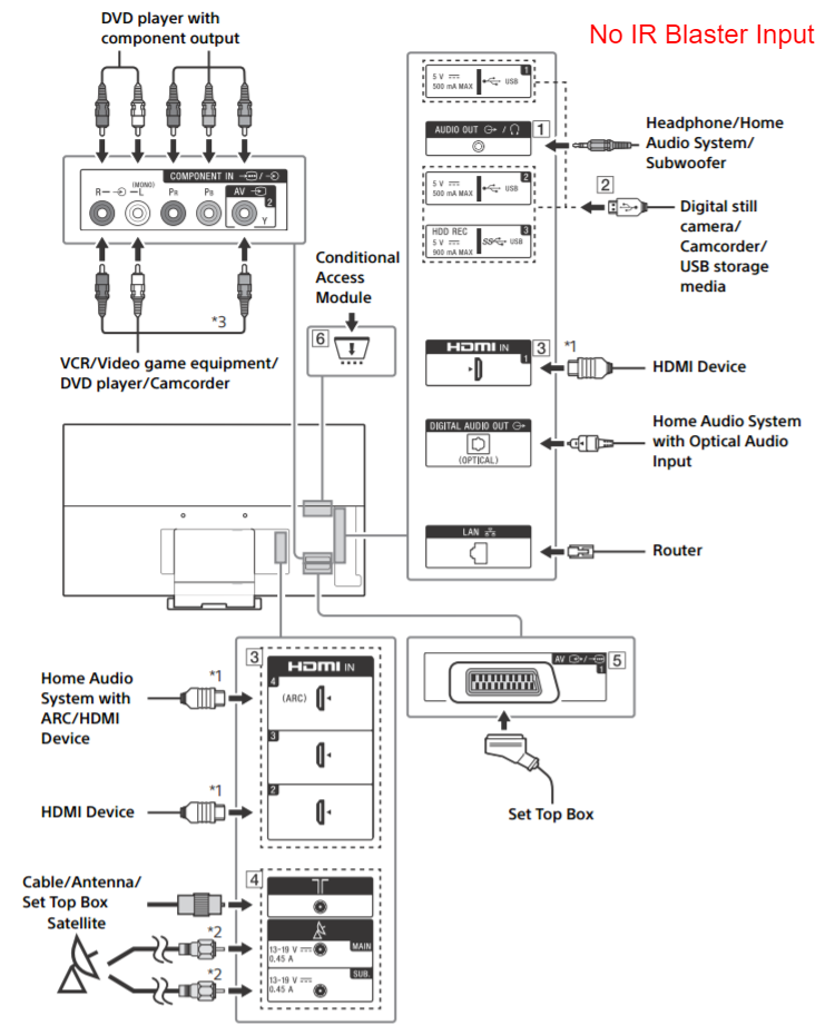

I'm focused on IR Blaster MENU but, USB? Is from an old device?
In a KD-49XD8305 IR Blaster is a mini jack input and there is only on a limited region/country/TV model.
Probably your XD94 Serie don't has IR Blaster...
XD8305 Connectors:
XD9405 Connectors:
Manolo

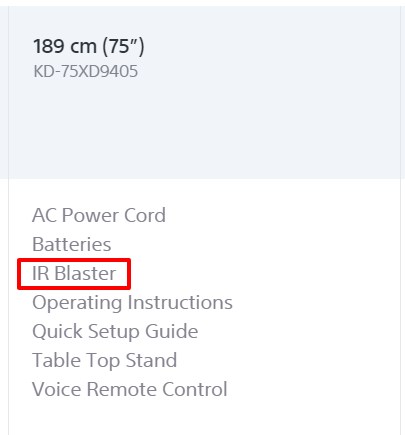

Oh and as far as the XD94 IR blaster support, the new IR blater is USB based, so you just plug it into one of the USB ports. :slight_smile:
profile.country.IT.title
Marino.Manolo
My fault for IR Blaster, before answer I haven't verified in the Sony UK site...
