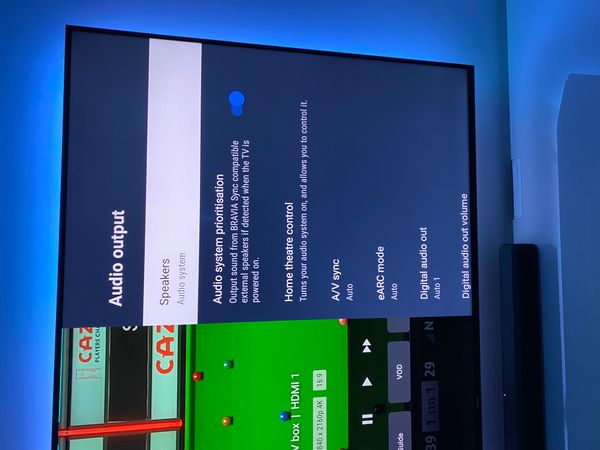

Hi All,
Nothing has changed on my TV and Soundbar setup but all of a sudden TV isn’t picking up the soundbar in Home Theatre and not syncing. Sound still works but can’t control volume etc from the TV. This has all been working fine for a year+
steps done so far:
- power cycled both sound bar and TV
- unplugged HDMI both TV and Soundbar end
- checked still plugged into HDMI 3 ARC
So random how this has suddenly stopped working!
any help would be appreciated!
thanks

Hi,
Im trying to use the TV remote. Previously when this was working turning on and off the TV would also turn on/off the sound-bar so worked seamlessly.
On further investigation it actually looks like its the Bravia Sync not working rather than this Home Theatre function (That must do something else)

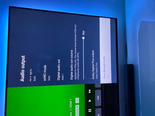

So after loads of fiddling, this is what I eventually done:
Turn off Bravia Sync and delete previous devices
Disconnect all HDMI devices
Power cycle the TV
Turn on Bravia Sync
Connect the sound bar only
Initially still didn't find the device
After some time later it eventually found it and now all working again
Something is really dodgy about Bravia Sync. But will see how stable it is now as had the same setup for over a year now before this problem and no issues.
