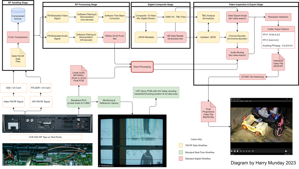

The final methods to tansfer video8 and hi8 are as follows.
Overview 8mm DiagramOverview 8mm Diagram

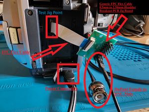

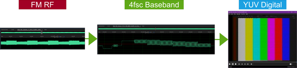

FM RF Archival --> Jig port from camcorder or 2.54mm headder on decks --> Single ADC --> FM RF file compressed in FLAC this preserves the orginal tapes signals in there native from in the analog domain, sampled like PCM audio but in Mhz range not Khz.
hifi-decode  for HiFi FM audio and vhs-decode which does software time base correction and conversion to YUV seprately this is the modern archive standard for 8mm/Betamax/Umatic and VHS all of the colour-under tape family are supported and formats like SMPTE-C are also supported and more.
Jig RF TapJig RF Tap

For proper archival capture a combination of FM RF and either DV25 and S-Video or both is recommended.
Sony 8mm tapes if stored right will have a very good signal to noise ratio, and if you have already used a poor qulality method and there is no tape damage its worth giving them a final archival run today.
Overview diagram for VCRsOverview diagram for VCRs
